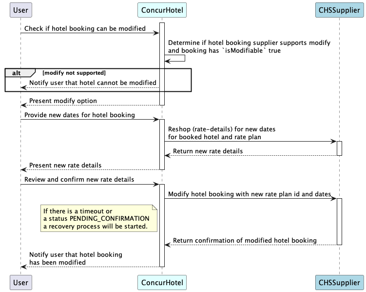

At a high-level, the workflow consists of:
  • If modify is supported by CHS supplier and booking is marked as modifiable, user is provided with option to change dates for hotel booking and user updates the dates (checkin/checkout/both).
  • SAP Concur invokes rate-details (used as reshop request) using same ratePlanId as used in original booking along with confirmationCodes that provides all confirmation codes and pin associated with booking.
  • CHS supplier provides price details for the new dates based on confirmation codes and/or original ratePlanId. Hotel room/product is expected to be the same as original booking. Note that ratePlanId in response can be different from original booking.
  • SAP Concur UI presents change in cost and new pricing to user for review.
  • User accepts and confirms the change request.
  • SAP Concur invokes modify endpoint with new dates and ratePlanId from previous response along with confirmation codes and pin.
  • CHS supplier updates the booking with new dates and returns the updated booking details with ReservationDetails model.
Below is the sequence diagram for the flow:
